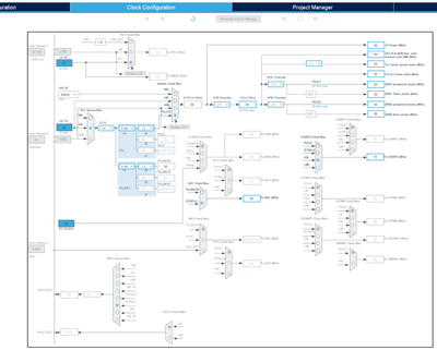

I’m now using PWM and DMA via Timer 1, Channel 2. HSI and PLL for a Sysclock of 80MHz.
