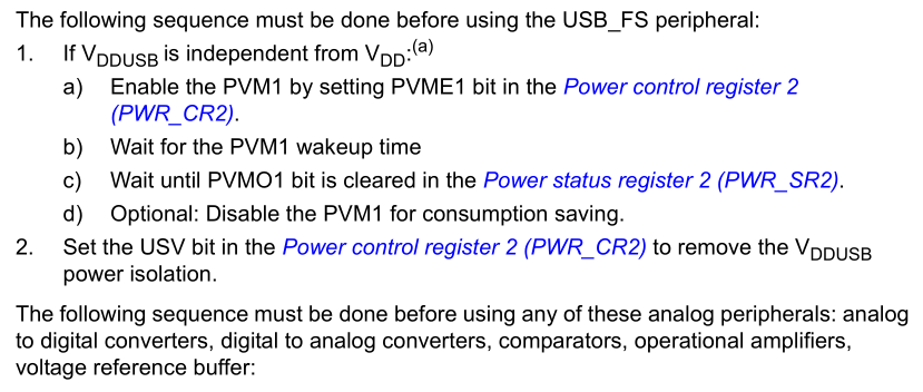

The procedure described in the datasheet is as follows:
What I do is the following:

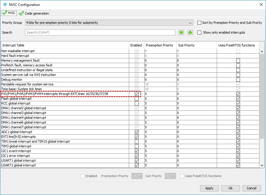

In the generated code I see it is enabled:
* Initializes the Global MSP. */void HAL_MspInit(void){ /* USER CODE BEGIN MspInit 0 *//* USER CODE END MspInit 0 */
__HAL_RCC_SYSCFG_CLK_ENABLE();
__HAL_RCC_PWR_CLK_ENABLE();HAL_NVIC_SetPriorityGrouping(NVIC_PRIORITYGROUP_4);
/* System interrupt init*/
/* MemoryManagement_IRQn interrupt configuration */ HAL_NVIC_SetPriority(MemoryManagement_IRQn, 0, 0); /* BusFault_IRQn interrupt configuration */ HAL_NVIC_SetPriority(BusFault_IRQn, 0, 0); /* UsageFault_IRQn interrupt configuration */ HAL_NVIC_SetPriority(UsageFault_IRQn, 0, 0); /* SVCall_IRQn interrupt configuration */ HAL_NVIC_SetPriority(SVCall_IRQn, 0, 0); /* DebugMonitor_IRQn interrupt configuration */ HAL_NVIC_SetPriority(DebugMonitor_IRQn, 0, 0); /* PendSV_IRQn interrupt configuration */ HAL_NVIC_SetPriority(PendSV_IRQn, 15, 0); /* SysTick_IRQn interrupt configuration */ HAL_NVIC_SetPriority(SysTick_IRQn, 15, 0);/* Peripheral interrupt init */
/* PVD_PVM_IRQn interrupt configuration */ HAL_NVIC_SetPriority(PVD_PVM_IRQn, 5, 0); HAL_NVIC_EnableIRQ(PVD_PVM_IRQn);/* USER CODE BEGIN MspInit 1 */
/* USER CODE END MspInit 1 */
}2. I enable the PVM1:
* @brief Enable the Power Voltage Monitoring 1: VDDUSB versus 1.2V. * @retval None */void HAL_PWREx_EnablePVM1(void){ SET_BIT(PWR->CR2, PWR_PVM_1); }3. Now I need to wait the ''PVM1 wakeup time'' but since I have no idea what is this time or I cant wait for the PVM1 interrupt as it doesnt work (I dont know why) I am stuck.
The PVM1 interrupt should work when I apply or remove voltage from VDD_USB if I understand correctly. For me it does not. Also the datasheet doesnt specify at any point what is the ''PVM1 wakeup time''.
When I use the debugger I see that the program acts as there is power (even though I do not supply it) but after I stop on the next line, I can see in the PWR_SR2 register that the flag is correct. It feels like its already to late when I stop with debugger and the flag changes...

2018-09-11 8:23 AM
In case anyone has a similar problem, here is the solution provided by ST:
Points 2 and 3 should be generated by CubeMX but are not. That was the problem.
