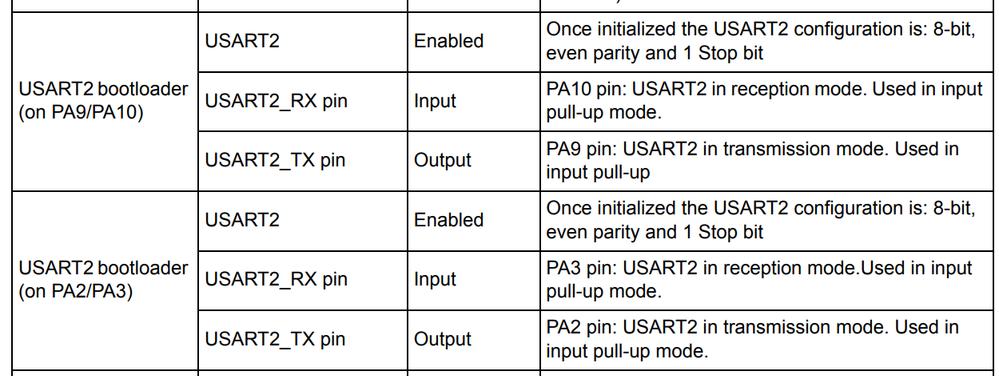

Hello, I'm attempting to flash firmware to aforementioned microcontroller using STM32CubeProgrammer. I have connected ST-Link VCP port to PA2 and PA3 ports, and i can communicate with my application fine. I even erased flash memory so I could be sure that device is in Boot mode. Unfortunately, I cannot connect to bootloader, log from Programmer below:

13:48:08 : Error: Activating device: KO. Please, verify the boot mode configuration and check the serial port configuration. Reset your device then try again... I'm wondering if listing both PA9/PA10 and PA2/PA3 as UART ports in documentation has anything to do with it. How does bootloader determine which of both pairs to use? Can pullups on PA2/PA3 connected to inactive I2C bus (because STM acts as master, also because of that and pin alternate functions being almost universally poorly laid out I couldn't use PA9/PA10) have something to do with it?

Well, both are USART2 on PA9/PA10 and USART2 on PA2/PA3, as I wrote in my question. And PA2/PA3 works with UART in my application. It just refuses to work with CubeProgrammer. I'm just puzzled how does bootloader configure USART to use either of pairs.
