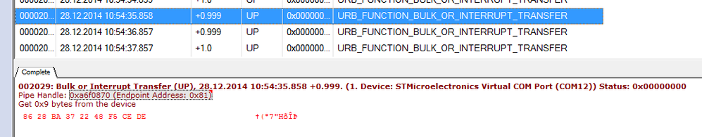

Now I am having problems with the CDC transmit. If I transmit 8 bytes or less the data is transmitted correctly. For example, I've been transmitting 12345678 and that comes out correctly. Keep in mind these are ASCII strings. Now if I try and transmit 123456789 I get 9 bytes of garbage. I've traced the code all the way down to PCD_WritePMA function. At that point it is still pointing to my buffer of data and the length is 9 bytes. I see it correctly grab the data and join it into 16-bits of data and then write it to memory location 0x40006000 which is the USB 512x16-bit SRAM section. I've attached a screen shot from a USB protocol analyzer that shows the garbage data. Has anyone seen this before?2015-12-28 8:56 PM

> .. Now if I try and transmit 123456789 I get 9 bytes of garbage. > .. and then write it to memory location 0x40006000 Sound like a problem around endpoint buffer assignment. STCubeMX (v4.50) doesn’t yet generate the code which assigns EP buffer for the CDC EPs. Manually add these code, as follows.
usbd_conf.c
#include ''usbd_cdc.h'' // <-- add this line for CDC_OUT_EP, CDC_IN_EP, CDC_CMD_EP macros
USBD_StatusTypeDef USBD_LL_Init (USBD_HandleTypeDef *pdev)
/* Init USB_IP */
/* Link The driver to the stack */
hpcd_USB_FS.pData = pdev;
pdev->pData = &hpcd_USB_FS;
hpcd_USB_FS.Instance = USB;
hpcd_USB_FS.Init.dev_endpoints = 8;
hpcd_USB_FS.Init.speed = PCD_SPEED_FULL;
hpcd_USB_FS.Init.ep0_mps = DEP0CTL_MPS_8;
hpcd_USB_FS.Init.phy_itface = PCD_PHY_EMBEDDED;
hpcd_USB_FS.Init.Sof_enable = DISABLE;
hpcd_USB_FS.Init.low_power_enable = DISABLE;
hpcd_USB_FS.Init.battery_charging_enable = DISABLE;
HAL_PCD_Init(&hpcd_USB_FS);
HAL_PCDEx_PMAConfig(pdev->pData , 0x00 , PCD_SNG_BUF, 0x18);
HAL_PCDEx_PMAConfig(pdev->pData , 0x80 , PCD_SNG_BUF, 0x58);
// <-- add these 3 lines
HAL_PCDEx_PMAConfig(pdev->pData , CDC_OUT_EP , PCD_SNG_BUF, 0x100);
HAL_PCDEx_PMAConfig(pdev->pData , CDC_IN_EP , PCD_SNG_BUF, 0x140);
HAL_PCDEx_PMAConfig(pdev->pData , CDC_CMD_EP , PCD_SNG_BUF, 0x180);
return USBD_OK;
Tsuneo
