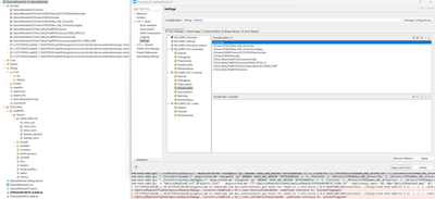

I am trying to create a project with FreeRTOS using CMSIS RTOS V2 without configuring it in the ioc file. I am trying to turn ON/OFF the LED using thread and timer. I can build and run the same project if I configure the freeRTOS in STM32CubeMX. But I want to configure it independently. I included all the files required by freeRTOS and CMSIS RTOS V2 for the project. Attached is .ioc file and error message.

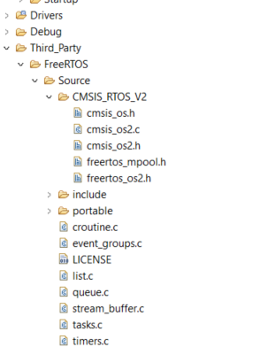

Missing C file: ...\Third_Party\FreeRTOS\Source\CMSIS_RTOS_V2\cmsis_os2.c
2025-03-12 8:32 AM
This file is included: Third_Party\FreeRTOS\Source\CMSIS_RTOS_V2\cmsis_os2.c

2025-03-12 7:05 PM
cmsis_os2.c hasn't compiled successfully.
