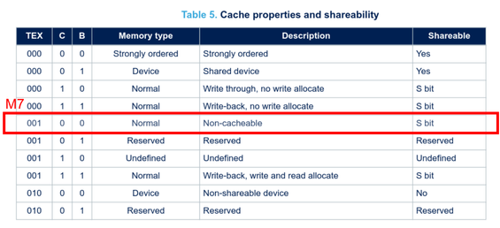

According to this application note, the F7 and H7 don't support hardware coherency.
It is a bit confusing, but if you want a non-cacheable region for a normal memory type, you need to set the TEX field as 1, cacheable as 0, and bufferable as 0 (see Table 5).
(I didn't understand the last column. If I set the shareable (s) bit, the I get hard fault.)

MPU_InitStruct.IsBufferable = MPU_ACCESS_NOT_BUFFERABLE;(this is equivalent to be equivalent to the first line in Table 5 (I don't know why. I would love if anyone could explain).
