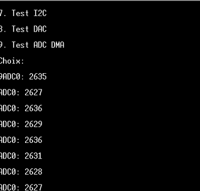

Ok thank you, that worked, here my new Callback :
void HAL_ADC_ConvCpltCallback(ADC_HandleTypeDef* hadc)
if(hadc->Instance == ADC1)
SCB_InvalidateDCache_by_Addr((uint32_t*)adc_buffer, sizeof(adc_buffer));
adc0_dma = adc_buffer[0]; // ADC1_INP0
flag_adc = 1;
if(hadc->Instance == ADC2)
adc0_it = HAL_ADC_GetValue(hadc);
flag_adc = 1;
}void adc_dma(void)
char buf[30];
HAL_ADC_Start_DMA(&hadc1, adc_buffer, 1);
while(1){
if (flag_adc == 1)
flag_adc =0;
int len = snprintf(buf, sizeof(buf), "ADC0: %u\r\n", adc0_dma);
HAL_UART_Transmit(&huart1, (uint8_t*)buf, len, HAL_MAX_DELAY);
}Result :
