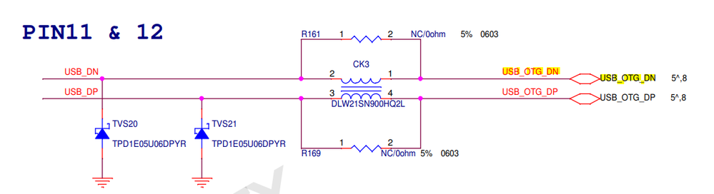

Here is the schematic related to USB for reference.

Suspect a hardware failure. Carefully visual inspect the board. Maybe a cold solder joint.
