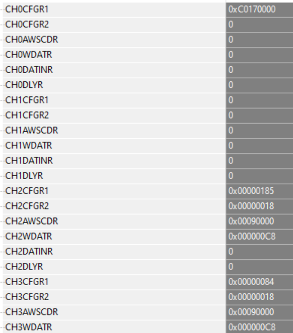

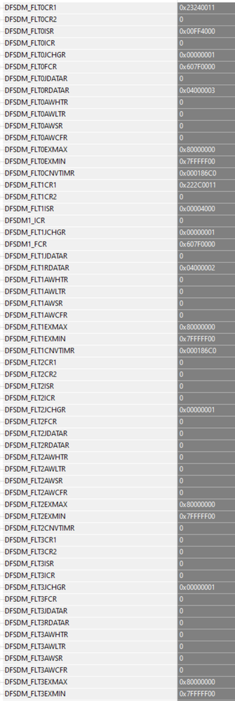

Problem: Filter->DMA bufer OK. HAL_DFSDM_FilterRegConvCpltCallback and HAL_DFSDM_FilterRegConvHalfCpltCallback function enter normally, but the data is wrong(always the same number).
I monitor the DFSDM registers, the RDATAR register no change.
