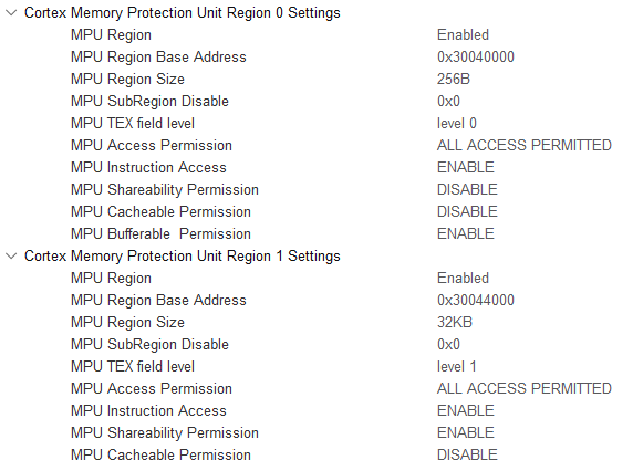

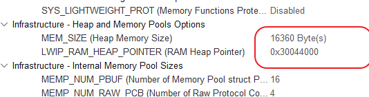

So, my settings looks like these:
LWIP settings:
I've added the following to the linker script:
/* Modification start */
.lwip_sec (NOLOAD) : {
. = ABSOLUTE(0x30040000);
*(.RxDecripSection)
. = ABSOLUTE(0x30040060);
*(.TxDecripSection)
. = ABSOLUTE(0x30040200);
*(.RxArraySection)
} >RAM_D2Sometimes, I get this error upon each ICMP packet that is received:
Assertion "pbuf_free: p->ref > 0" failed at line 753 in ../Middlewares/Third_Party/LwIP/src/core/pbuf.cAgain, it goes away when I disable the dcache. I'm not sure what else to try. I must have something not quite right. Thanks.
