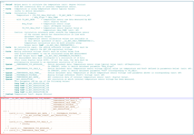

2024-08-30 8:18 AM
Hello @SITARAM,
It seems that you're having problems with the internal temperature values.
This could be linked to the calculate temperature function. I recommend checking the "__LL_ADC_CALC_TEMPERATURE_TYP_PARAMS" function available in the stm32h7xx_ll_adc.h driver and verifying its parameters.
You can also refer to the STM32H7 reference manual for detailed information on configuring the internal temperature sensor and ADC.

2024-09-02 2:57 AM
TEMPCELSIUS =__HAL_ADC_CALC_TEMPERATURE_TYP_PARAMS(2000,620,3300 ,TEMPSENSOR_CAL_VREFANALOG,temp_sensor,ADC_RESOLUTION_16B);when i do this function then in TEMPCELSIUS VALUE CAME A 3400 CELCIUS WHY THIS Value came give me solution
