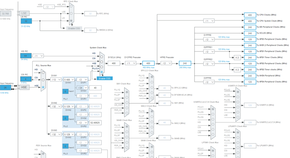

I'm using a custom board with the STM32H743XI MCU with an external clock of 26MHz and the STM32CubeH7_FW_H7_V1.11.0 package.
Please find below a picture of the STM32CubeMX Clock configuration:
Here is the code that setup the clock:

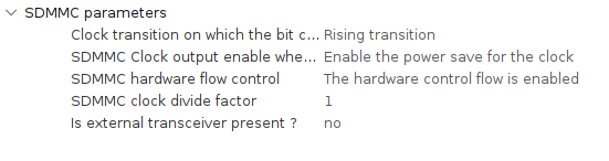

g_sd_handle.Instance = SDMMC1;
g_sd_handle.Init.ClockEdge = SDMMC_CLOCK_EDGE_RISING;
g_sd_handle.Init.ClockPowerSave = SDMMC_CLOCK_POWER_SAVE_DISABLE;
g_sd_handle.Init.BusWide = SDMMC_BUS_WIDE_4B;
g_sd_handle.Init.HardwareFlowControl = SDMMC_HARDWARE_FLOW_CONTROL_DISABLE;
g_sd_handle.Init.ClockDiv = 0;
assert_param(HAL_SD_Init(&g_sd_handle) == HAL_OK);

}The first steps of the HAL_SD_InitCard() must be performed with a clock that is less than or equal to 400Khz. My SDMMC clock is configured to 40Mhz so the code inside HAL_SD_InitCard() divide it to match the 400Khz requirements.
Init.ClockDiv = sdmmc_clk / (2U * SD_INIT_FREQ);
Init.ClockDiv = 40000000 / (2 * 400000) = 50
sdmmc_clk = sdmmc_clk / (2U * Init.ClockDiv);
sdmmc_clk = 40000000 / (2 * 50) = 400000
HAL_Delay(1U + (74U * 1000U / (sdmmc_clk)));
HAL_Delay(1 + (74 * 1000 / 400000))
=> HAL_Delay(1.185)
But a delay of 1.185ms seems too low and makes the SD_PowerON() function fail.
Obviously touching this delay and the code inside the stm32 hal library is not a solution, so I don't know what I could change in the application to make it work.

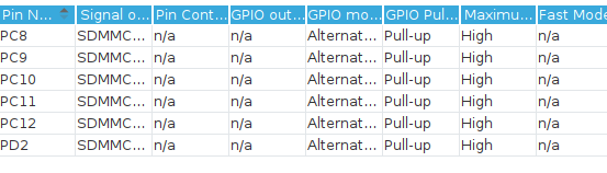

on my H743 board here i use this setting :
try this settings. there never was a startup problem; just "very high" port speed may not work, try medium or high.

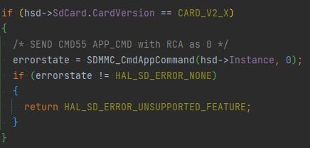

2023-01-28 11:15 PM
hi,
same issue with maine for controller-STM32H723VGT6.
After a deeply study ,i also found issue with sd card initialization on the level of.....
if (hsd->SdCard.CardVersion == CARD_V2_X)
/* SEND CMD55 APP_CMD with RCA as 0 */
errorstate = SDMMC_CmdAppCommand(hsd->Instance, 0);
if (errorstate != HAL_SD_ERROR_NONE)
return HAL_SD_ERROR_UNSUPPORTED_FEATURE;
please share the solution ,how you have been resolved .
