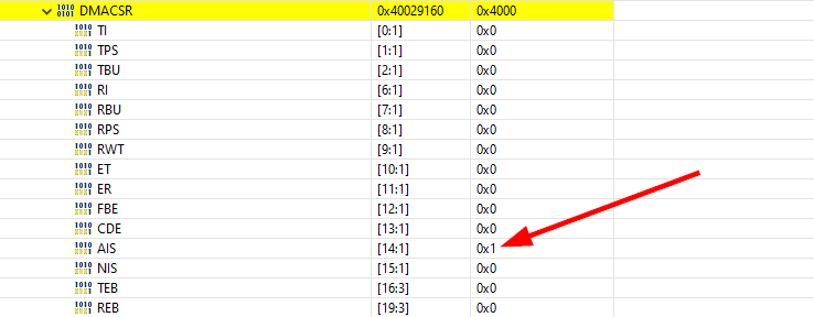

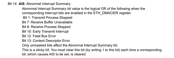

I have a question regarding the STM32H7 ethernet interrupts. I have lwIP + freeRTOS running successfully on the device. All fixes which were indicated by @alister were applied and it runs quite stable. The strange part is that when I apply a massive load onto my device by sending a lot of packets to the device, sometime the AIS interrupt triggers. Most of the time this is causes by RBU, which I understand and I can solve. But sometime only the AIS flag is set in DMACSR register. How could this be? I thought the AIS is the OR combination of other errors which occured.

AIS is set when any of the error conditions it summarises occur. But it is sticky, which means it needs writing to clear.
AIS and NIS are documented as sticky and RBU and others are not. Possibly the documentation is incorrect. But it should not matter if the interrupt handler is coded well.

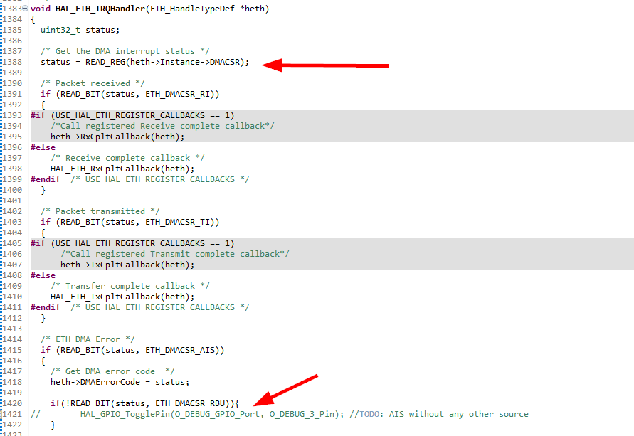

I have checked the read of ETH_DMACSR. It is correct, The code reads it once on the entry of the IRQ and clears then only the read bits. My comparison, if AIS is set without any other flag is immediatly after the read of ETH_DMACSR.
So it really looks like that AIS can occur "standalone", very strange. Could be really a wrong documentation.

Your posted code checks RBU isn't set, but doesn't check only AIS is set. Are you sure?

All the status bits summarized by AIS should be sticky and the ST driver is coded as thought they are. It's questionable whether AIS itself should be sticky as that invites races. I've neither looked for it nor observed it.

to be sure I changed my code just to track really only AIS is "standalone". Once with debugger enabled and once without. I also checked if anywhere else in the code, except the IRQ, is an write access to DMACSR. There isn't. So it's cleared only in the IRQ with the read status bits and once in the _ETH_Start() function. I tracked it with an Oszilloscope and with and without debugger it happens sometimes.
