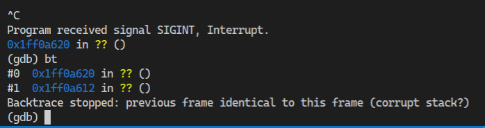

I've tested this behavior both on a custom board (H743ZI rev V), and on a Nucleo-H743ZI2 with the same results. If I break in to the debugger in either of the not-working scenarios, I can see the program counter is in the bootloader's code somewhere, so it *is* jumping in, but USB doesn't work.

I did a bit of reverse engineering with Ghidra + GDB, and there's a function with a big loop that checks, in sequence:
(curiously, this doesn't match the order of checks in AN2606 :o)
In the USB OTG interrupt, that same struct in RAM is set to contain the "cable present" value. But that condition is never happening, so USB isn't getting initialized for whatever reason.
