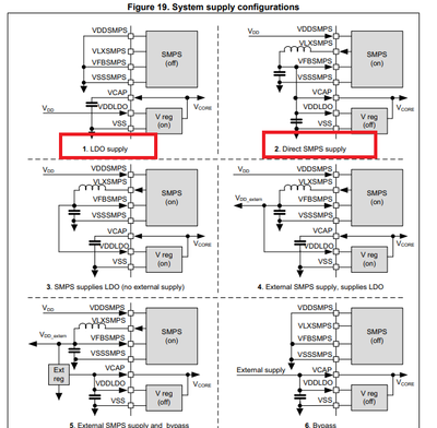

Most probably you programmed your MCU with the wrong power supply. STM32h735G-DK board is configured by HW in SMPS, and you maybe configured it in your application in LDO:
See this thread: https://community.st.com/t5/stm32-mcus-products/bricked-after-first-debug-stm32h735g-dk/td-p/231942
So if it's the case you need to recover your MCU from this situation. Please review that article.
