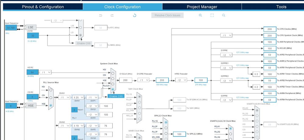

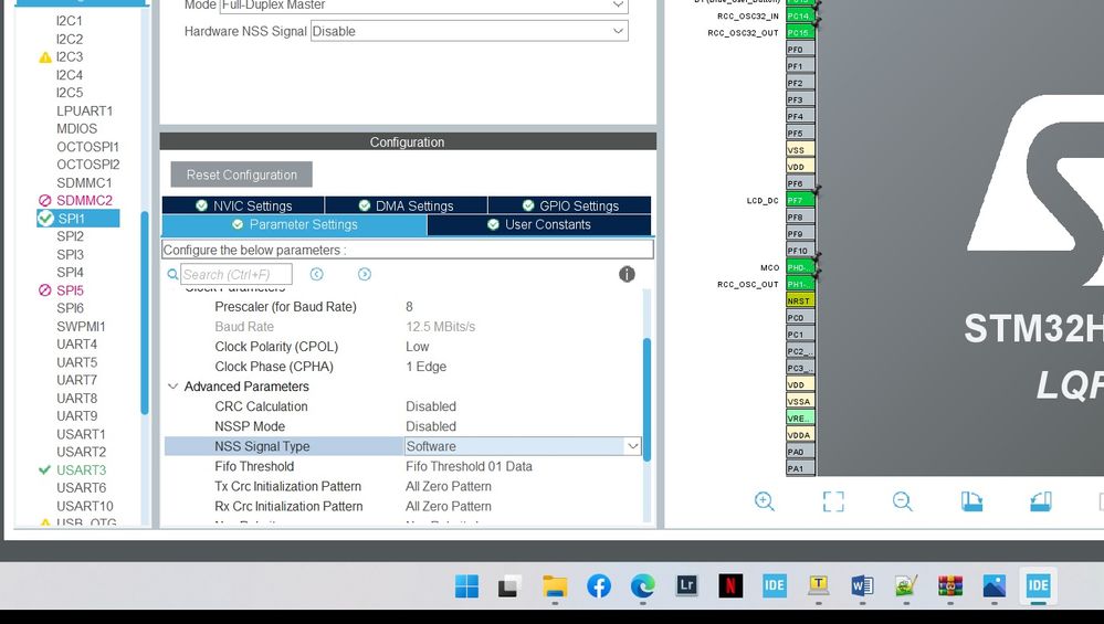

Configure Spi from CUBE default peripherials.. set all same like in f446 and... Nothing. Zero communication with lcd..
I tried a lot things and ideas.. used registers, used hal_transmit, hal_transmitreceive.. nothing... Same ideas work correct in f446.. in h723 im not able make connection with lcd..
Debugger show nothing.. all is okay when i go step by step.. i think somhing bad is with configuration SPI?
Pls help because im so close to bring to trash this h7 :(

Hi @Marcin Kozłowski and welcome to the Community :),
Make sure that the pins are well configured (SPI1_SCK , SPI1_CS ...) for that you can refer to the User Manual UM2407.
Also, I advise you to get inspired from the available SPI examples in the STM32CubeH7 MCU package. These examples may help you in the configuration by following the instructions in the readme file.

2022-08-02 7:21 AM
Check your board's schematic, maybe your pin(s) shared with another hardware function via jumper or resistor.
