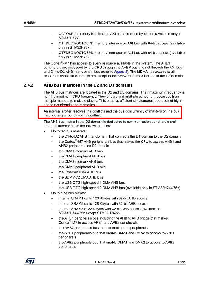

I could not find any info about the priorities of non-DMA1/2 masters, esp. DMA 1/2 vs. ethernet DMA is important for me.
STM32H723..735

Unless you get some more authoritative answer, expect them to be arbitrated round-robin by the AHB matrix arbitrator (including other masters, like the AXI-AHB bridge through which processor and MDMA accesses the D2 slave lanes).

So until now I cannot influence these priorities on the AHB side, or is there something like the AXI QoS registers (quality of service = priority, AXI_INIx_READ_QOS) for the AHB?

IMO no.
