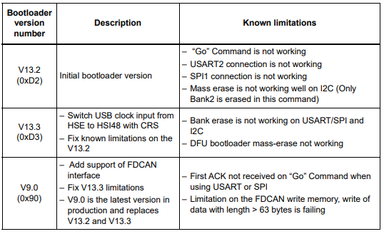

Hello @Dub Bartolec ,
Could you please let me know the bootloader versions on both devices (rev Y and rev V)?
You can get it @0x1FF1E7FE .
Details about the known limitations on bootloader versions are provided on table Table 91of AN2606. STM32H74xxx/75xxx bootloader version:
-Amel
2020-01-23 3:12 AM
Hi Amel,
I am sorry to say but this table above is all wrong.
In fact GO command works in v13.2 (Rev Y chip) but it doesn't in v9.0 (Rev V chip) as per my report.
Please refer to my answer to Imen at this thread and perhaps we should continue this conversation there:
2020-01-23 7:12 AM
