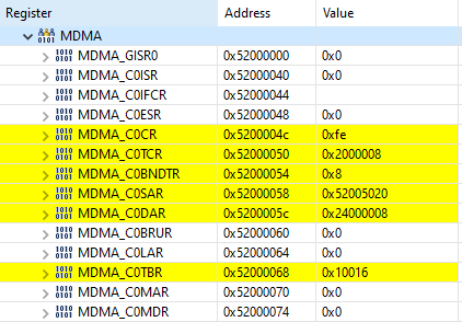

These are the MDMA registers when I enable the MDMA at step 5:

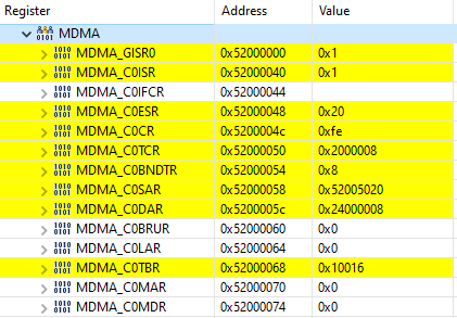

These are the MDMA registers when I get the error interrupt at step 6:

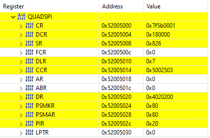

These are the QUADSPI registers when I enable the MDMA at step 5:
These are the QUADSPI registers when I get the error interrupt at step 6:

The issue that caused the error was
MDMA_CxTBR_SBUSChanging that from 1 to 0, and it no longer crashed. The other issue I faced which is why I though this was RTOS related was that the FreeRTOS variables shared the same memory in RAM as my local variables.
