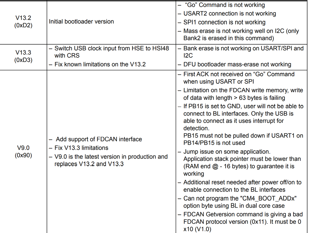

JRead AN2606 H74xxx limitations page 273 now

Actually I read it several times already. If you mean the part with jump issue, I already tried to move stack pointer to different address (Ram end @ - 16 and lower) - in ld script, but nothing has changed.
2022-09-20 6:53 AM
Your info is oposite to pdf. 0XD2 in AN GO not work at all.
0x90 ...

Normal is GO to addr 8000000 if code is linked here. Bootloader then reads from this addr to real start.
Limitations cant be corrected only with replacing system boot with your own bootloader .
