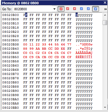

1. erasing the flash sector
1. Writing first Block of data
// 1 2 3 4 5 6 7 8 9 0 1 2 3 4 5 6 7 8 9 0 1 2 3 4 5 6 7 8 9 0 1 2
const char Teststr3[] = ''00112233445566778899AABBCCDDEEFFC0C1C2C3C4C5C6C7C8C9CACBCCCDCECF'';const uint32_t address3 = 0x08020B38;const uint32_t length3 = 0x25-5; // 32All seems to be ok.

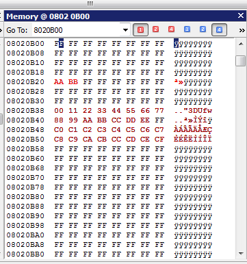

2. Writing the second Block of data
// 1 2
const char Teststrx[] = ''AABB'';const uint32_t addressx = 0x08020B20;const uint32_t lengthx = 0x2; // 23. Writing next Block of data
// 1 2 3

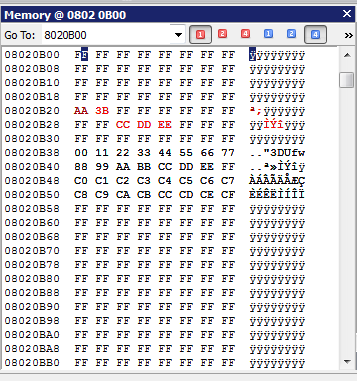

const char Teststry[] = ''CCDDEE'';const uint32_t addressy = 0x08020B2A;const uint32_t lengthy = 0x3; // 3What happend ?
Memory 0x8020B1 changed from BB --> 3B

2017-12-06 9:43 AM
Most likely due to ECC and faulting. ie trying to fix vs detect multiple bit errors
The flash lines are 256 + ECC bits in length, when you start cherry picking what you write and rewrite into the line you're likely to break things.
When processing sparse or unaligned hex files you really need to cache the data in larger blocks, and flush the data as aligned lines into the Flash array, and finally once you've encountered the terminal record. Either your S-Record processing needs to get smarter and handle multiple lines so it can fold into single aligned writes, or you work with packaged binary data, and use something like X-Modem with larger and aligned blocks.

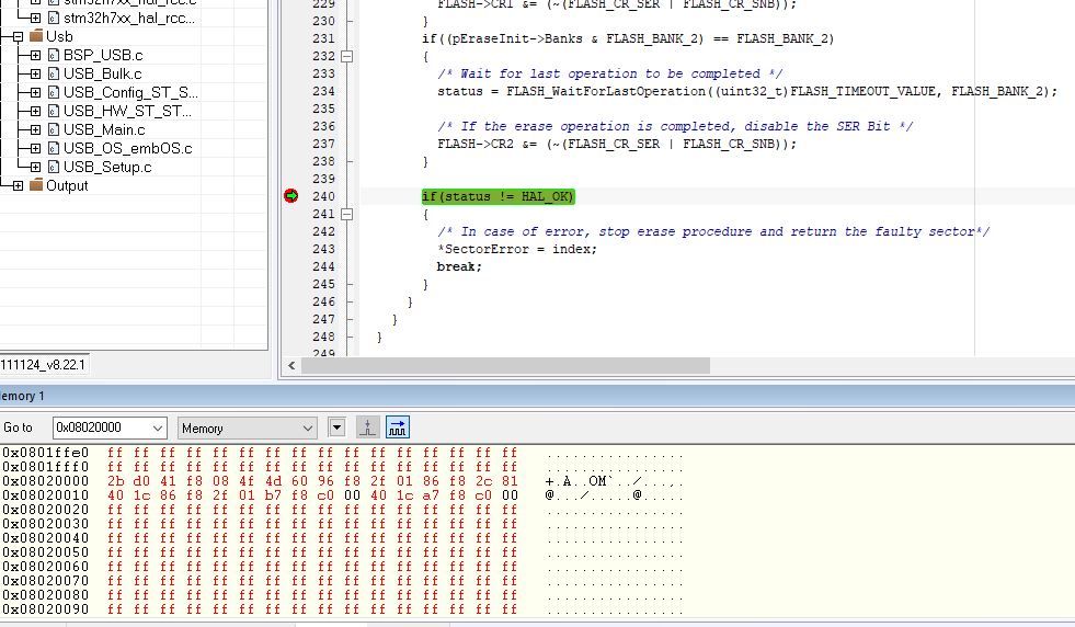

Hi, I am using V1.2.0 of stm32h7xx_hal_flash_ex to erase individual sectors. Directly after the erase cycle I do a blank check which reports errors. When setting a breakpoint I can see in the debugger that effectively the flash is not empty:
When stepping the flash contents updates and then it is completely erased.
I have tried with different voltage range settings but nothing helps. What could be the issue here?

Hello Andre,
1/ Does the HAL API HAL_FLASHEx_Erase() report a HAL_ERROR or HAL_OK?
2/ Is Cache activated in your application?
In fact, when cache is activated, the CPU could be seeing an old data available in cache, and not the new data available in flash memory. So, a cache maintenance in needed after erase.
BR,
