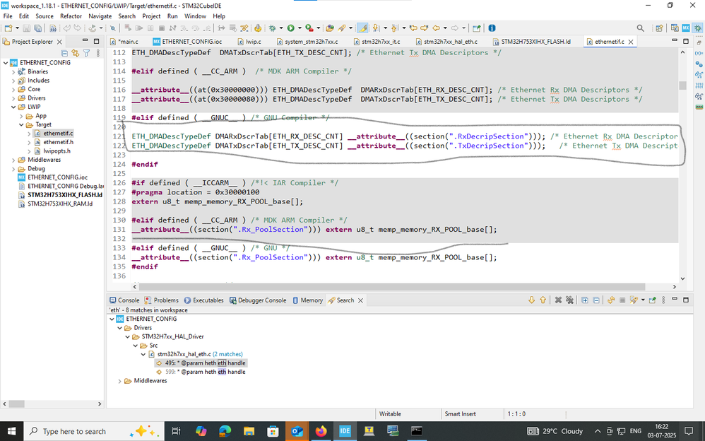

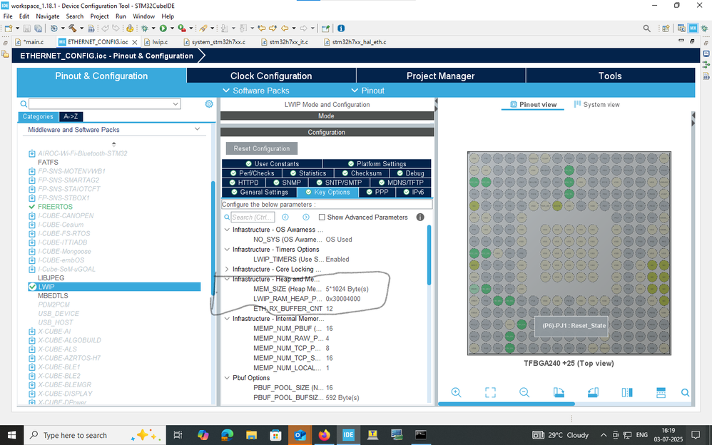

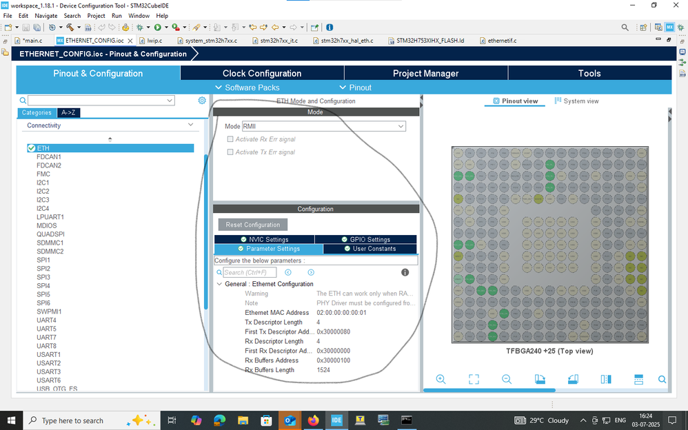

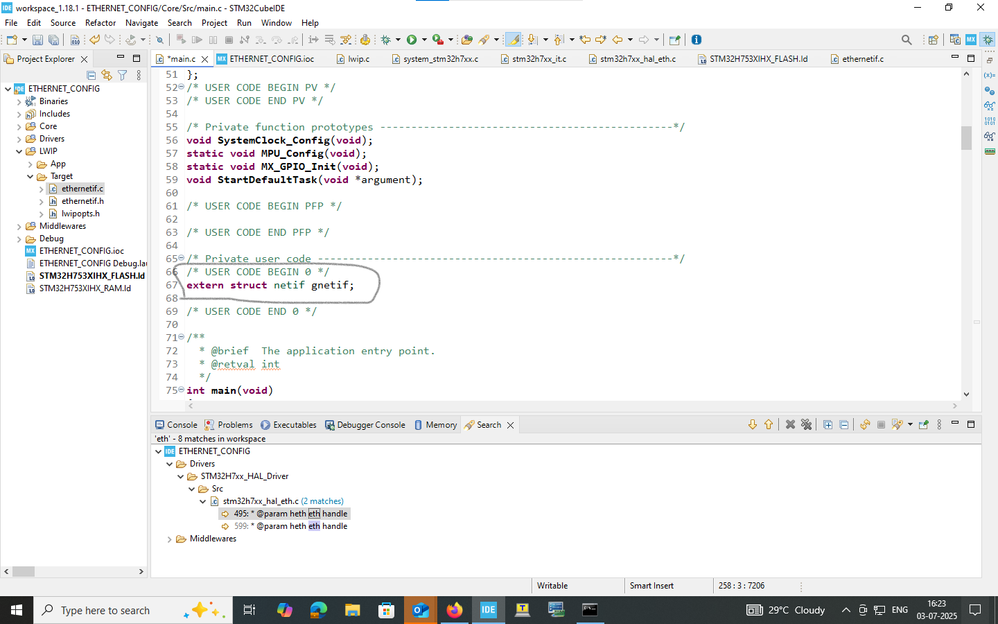

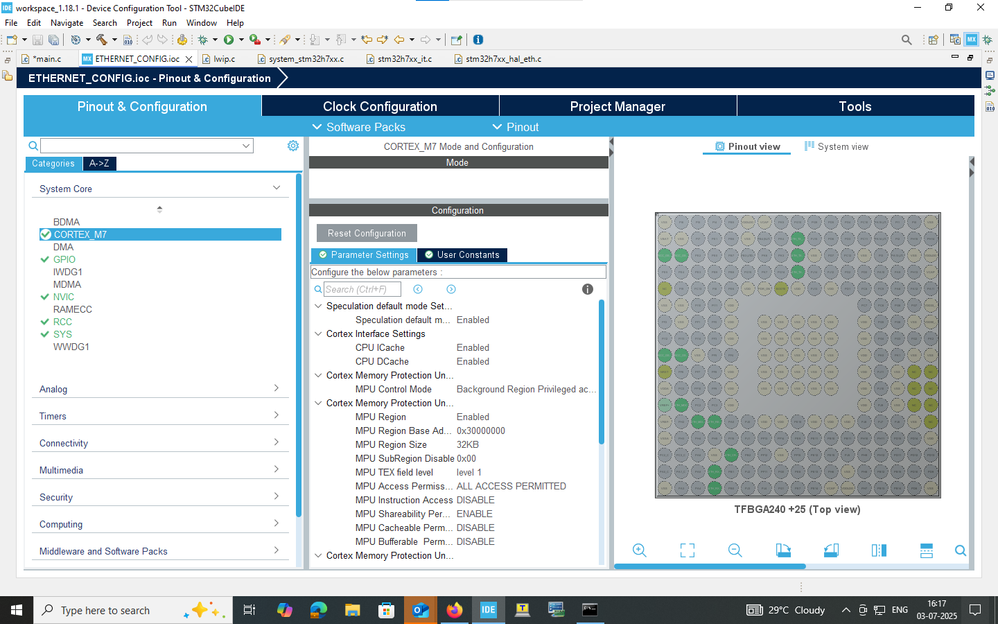

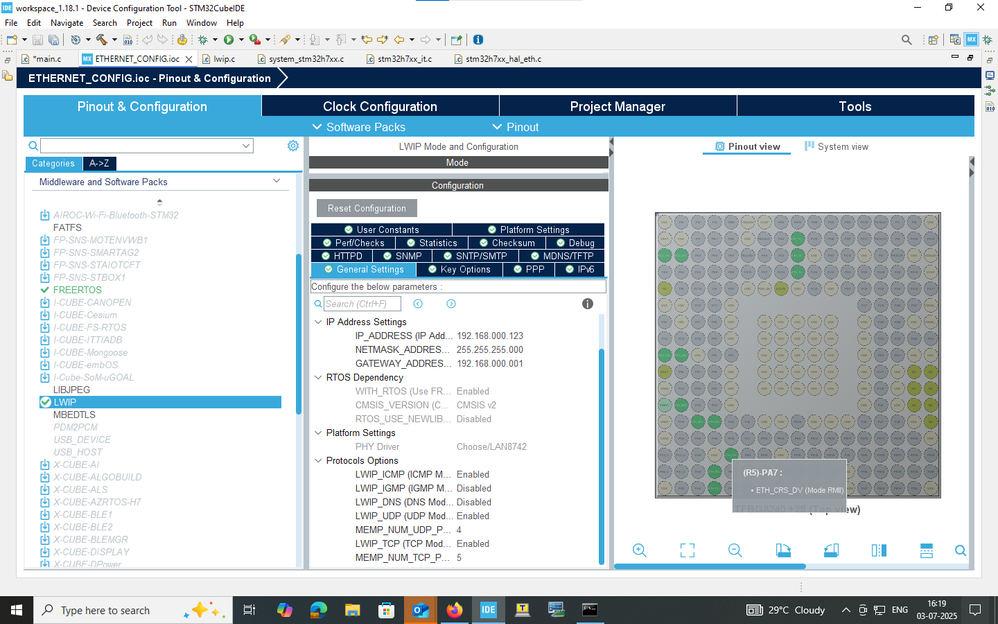

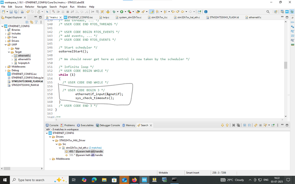

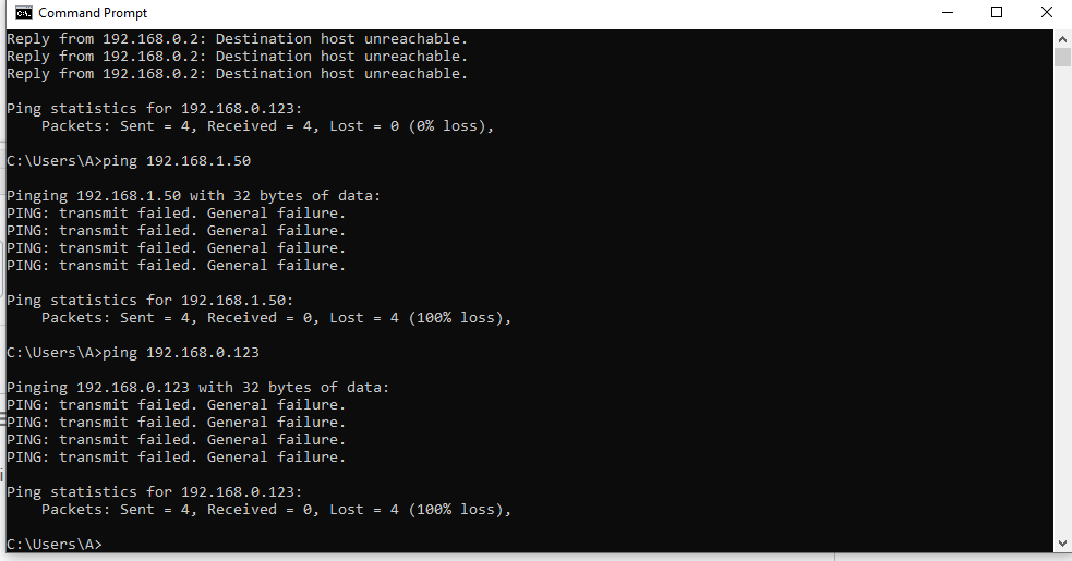

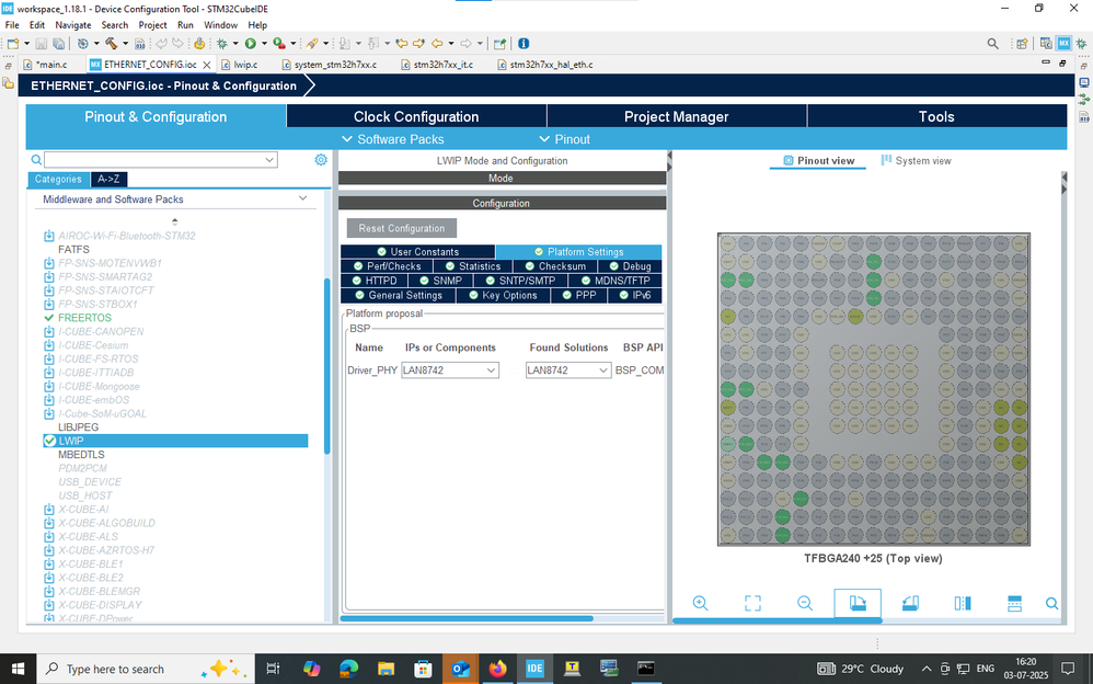

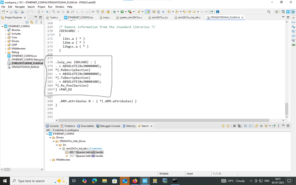

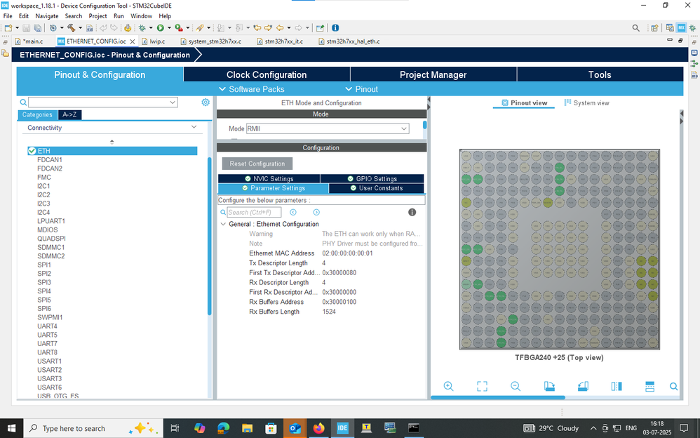

this config and code i am using to run eternet in my stm32h753xi6 chip i am getting this output when i am ping ip
2025-07-03 4:03 AM
can you please help me how i am config and what code i am use to successful run eternet in the stm32h753xi6 chip.
