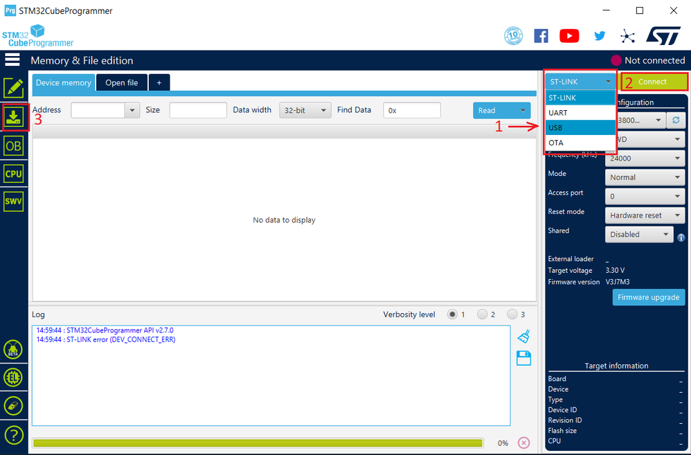

I'm working with the STM32F7 dual-core capability for the first time. Using NUCLEO-H745ZI-Q, DfuSe Demo v3.0.6, DFU File Manager v3.0.6
I have one program for the CM7 core and another for the CM4 core. I can enter the system bootloader by applying 3.3V to BT0 on my NUCLEO-H745ZI-Q board. Here's my testing:
I'm curious how to utilize the DFU to program for both cores. What am I missing? Can you point me to any threads or documentation dealing with this issue?
Thanks

Dear @SEast.1
We recommend to use STM32CubeProgrammer a replacement of Dfuse tool.
The tool is downloadable from this link: https://www.st.com/en/development-tools/stm32cubeprog.html.
These are the steps to use this tool to use DFU bootloader on dual core (see screenshot):
0- Connect your USB FS of the board, connect BT0 to VDD and push reset.
1- From the menu select USB instead of STLink (default option)
2- Click "Connect" button.
3- Browse and select the hex file you want to download.
Normally you can do any handling on OB or the Flash.
So you can download either CM7 program or CM4 program binaries with this manipulation.

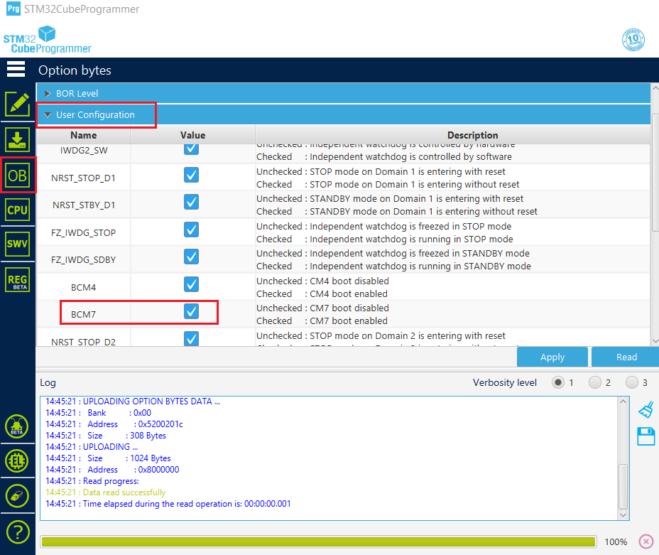

Note that you can do this operation only if the cortex-M7 boot is enabled in option byte as it's the only the core that runs the bootloader:

2021-07-14 7:25 AM
This was exactly what I was looking for because I was using the incorrect software. I'll need to play around with the STM32CubeProgrammer more, but I was able to load my programs on to different cores in DFU.
Much appreciated!
