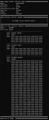

Also I took a dumpinfo of the signed firmware binary file using this command (imgtool dumpinfo C:/Users/Naveen/Documents/Project/build/zephyr/zephyr.signed.bin)
In Image header I observed that the field protected_tlv_size = 0, does this means the firmware isn't signed properly?
