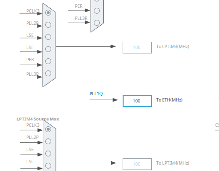

}From what I've read on this forum, the ETH somehow needs an external clock input from the transceiver. However, ETH_REF_CLK is only defined in RMII mode, but I want MII mode with RX and TX clocks. Does it still need permanently running clock? ETH_RX_CLK is currently served from the transceiver with 2.5 MHz (in 10 Mbps mode), the ETH module itself is clocked 100 MHz from PLL1Q:
