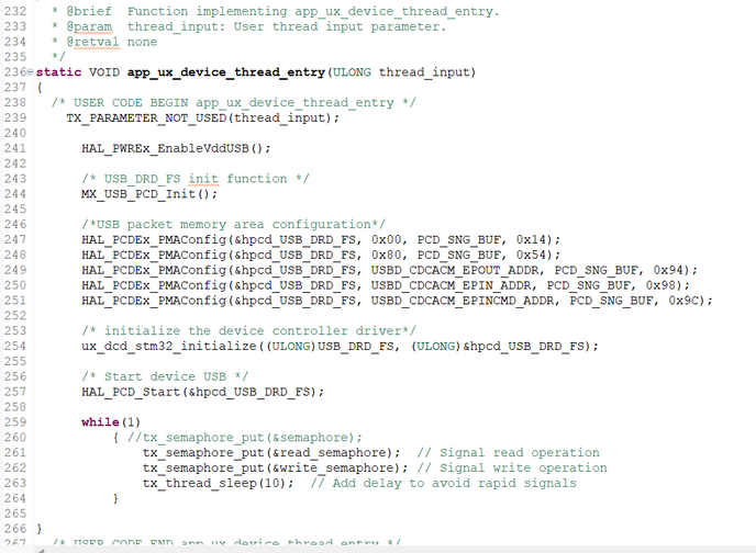

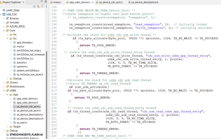

Inside app_usbx_device.c file,
these two threads(for read and write) were created inside MX_USBX_Device_Init() function.
I am giving semaphore inside the while loop here...

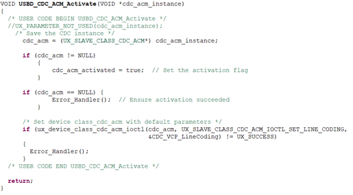

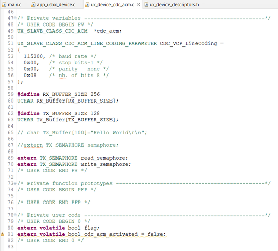

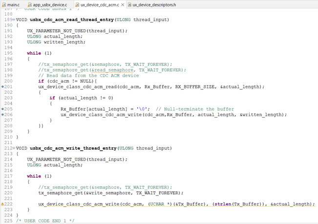

Inside ux_device_cdc_acm.c file,
I am declaring variables...
I am defining the read and write functions like this...

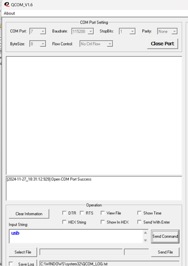

it's not taking any input data

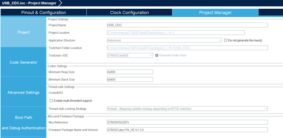

this is the heap and stack size I'm giving,

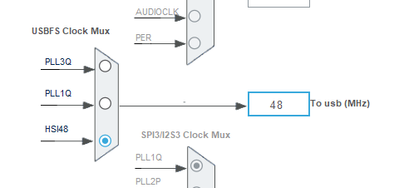

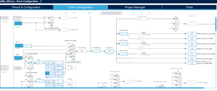

clock configuration,
to USB,

2024-11-28 2:44 AM
One item to be careful with is the PCD buffer configuration. It seems to be dependent on the chip family, device profile, and different examples have different values.
The G4 article quoted by @Imen.D has these values for CDC on a G4:
HAL_PCDEx_PMAConfig(&hpcd_USB_FS, 0x00 , PCD_SNG_BUF, 0x40);
HAL_PCDEx_PMAConfig(&hpcd_USB_FS, 0x80 , PCD_SNG_BUF, 0x80);
HAL_PCDEx_PMAConfig(&hpcd_USB_FS, 0x01, PCD_SNG_BUF, 0xC0);
HAL_PCDEx_PMAConfig(&hpcd_USB_FS, 0x81, PCD_SNG_BUF, 0x100);
HAL_PCDEx_PMAConfig(&hpcd_USB_FS, 0x82, PCD_SNG_BUF, 0x140)this example for CDC on H533:
\STM32Cube\Repository\STM32Cube_FW_H5_V1.3.0\Projects\NUCLEO-H533RE\Applications\USBX\Ux_Device_CDC_ACM\USBX\App\app_usbx_device.c
has these values:
HAL_PCDEx_PMAConfig(&hpcd_USB_DRD_FS, 0x00, PCD_SNG_BUF, 0x14);
HAL_PCDEx_PMAConfig(&hpcd_USB_DRD_FS, 0x80, PCD_SNG_BUF, 0x54);
HAL_PCDEx_PMAConfig(&hpcd_USB_DRD_FS, 0x81, PCD_SNG_BUF, 0x94);
HAL_PCDEx_PMAConfig(&hpcd_USB_DRD_FS, 0x01, PCD_SNG_BUF, 0xD4);
HAL_PCDEx_PMAConfig(&hpcd_USB_DRD_FS, 0x82, PCD_SNG_BUF, 0x114);and this example, for CDC+HID on H563:
\STM32Cube\Repository\STM32Cube_FW_H5_V1.3.0\Projects\NUCLEO-H563ZI\Applications\USBX\Ux_Device_HID_CDC_ACM\USBX\App\app_usbx_device.c
has this:
HAL_PCDEx_PMAConfig(&hpcd_USB_DRD_FS, 0x00, PCD_SNG_BUF, 0x20);
HAL_PCDEx_PMAConfig(&hpcd_USB_DRD_FS, 0x80, PCD_SNG_BUF, 0x60);
HAL_PCDEx_PMAConfig(&hpcd_USB_DRD_FS, 0x81, PCD_SNG_BUF, 0xA0);
HAL_PCDEx_PMAConfig(&hpcd_USB_DRD_FS, 0x01, PCD_SNG_BUF, 0xE0);
HAL_PCDEx_PMAConfig(&hpcd_USB_DRD_FS, 0x82, PCD_SNG_BUF, 0x120);
HAL_PCDEx_PMAConfig(&hpcd_USB_DRD_FS, 0x83, PCD_SNG_BUF, 0x140);so a detailed study of the Reference Manual for the chip to be used is required.
