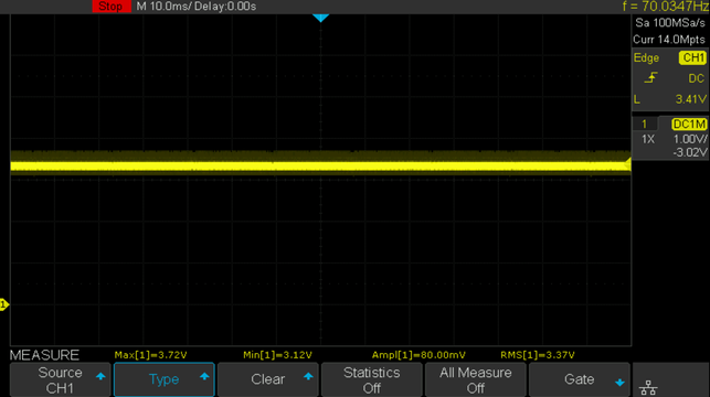

This is the 3v3 to gnd power supply that feeds the MCU
