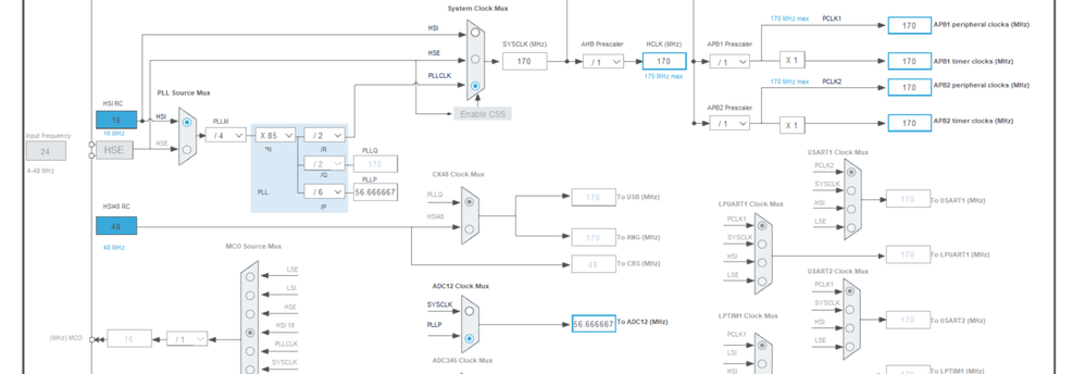

Main clock is HSI + PLL (170MHz) for TIM and ADC is configured at 56.66MHz, so a single ADC input should be done in less than 10us (1/100kHz).

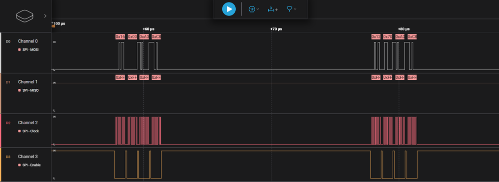

In next figure I represent 50kHz ADC sampling and SPI sending (20us between SPI send) sending 4 bytes.

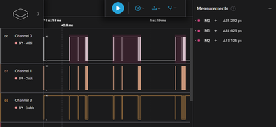

Cons: Difficulty to reduce non-deterministic transfer time and baud rate for SPI. Here I show how data transfer at 20kbauds (desired 50us between data package) could result in a conversion time from 12us (24% of real time) to 31us (62%). I will consider reducing SPI clock to 10Mbps and reduce baud rate to 1kHz or even 100Hz as it is only for external datalogging.
