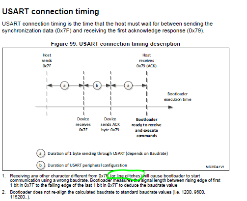

Maybe is worth to hook up an oscilloscope to take a look to your signal integrity
2023-01-23 2:34 AM
I watch the voltages and they are pretty clear ..
