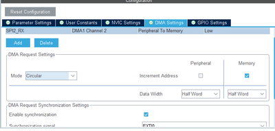

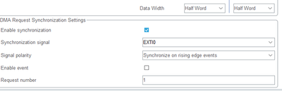

I tried it also to start the SPI DMA read with the cubeMX:
The trigger was here Interrupt from the Input EXTI0, even here it does not worked.

2024-12-19 6:30 PM
Ahh, it's a slave. I missed that. If you're just receiving, then you don't need to worry about TX at all.
In that case, I don't understand what TIM1 is doing here. If you want to receive SPI data into a circular buffer, that can be done without a timer.
If your register level code isn't working, I would suggest coding it up using CubeMX and HAL and HAL_SPI_TransmitReceive_DMA(...), and then copying those register settings. It should be straightforward
