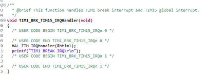

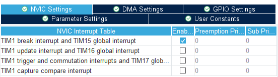

I'm using STM32G4 with TIM1 for motor control. The BKIN hardware protection works correctly - when I pull the BKIN pin (PB10) low, the motor stops, and when high, it runs again with AOE enabled. However, the break interrupt never fires and HAL_TIMEx_BreakCallback is never called. I've verified that TIM1_BRK_TIM15_IRQHandler exists in stm32g4xx_it.c, NVIC is enabled. The break flag never gets set even though BKIN is functioning. What could prevent the break flag from being set while the hardware break feature still works?
I want to print diagnostic using BKIN callback routing but it doesn't work.
I've attached IOC timer configurations.

Could you please check if the break interrupt (BIE) is enabled in the TIMx_DIER register?

Hey @Saket_Om ,
No, BIE is not set, but when I manually enable the BIE bit, the callback works. What could be the reason for this?
TIM1->DIER |= (1 << 7);
2025-12-02 11:38 AM
Use HAL_TIMEx_PWMN_Start_IT to start the channel
This would be much easier to diagnose if you showed your full code.
2025-12-03 12:52 AM
Hello @batuhanky
The API that you are using to start the timer is not enabling the break interrupt.
Try to use HAL_TIMEx_PWMN_Start_IT as suggested by @TDK.
