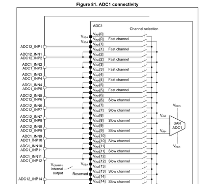

Using the ADC's Differential Function,But I can't find ADC12_INN1 ADC12_INP1 match PIN ?

Better look at the rm -> ADC1/2/3/4/5 connectivity , to see whats possible for ADCx :
And when you set the channel in Cube, it anyway shows you, whats possible and on which pin you get the input.
2024-02-04 5:33 AM - edited 2024-02-04 5:36 AM
If you set IN1 -> differential, IN1 + IN2 are now _INP1 + _INN1 : (IN2 cannot use separate then)
+ on pins of IN1 + IN2 then:

May I take ADC1_INx---INP and ADC1_IN(x+1) --- INN?
2024-02-04 10:44 PM
