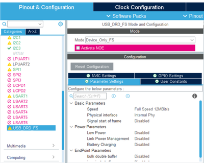

I am working with STM32G0B1CETx for an application as a replacement of STM32F105VCTx. I want to use to USB as Custom Human Interface Device Class. I am using CubeMx with MDK-ARM. I have configured USB_DRD_FS as Device_only_FS and Middleware section -> USB_Device i configured the same params as STM32F105VCTx for STM32G0B1CETx .
When USB is plugged to Laptop STM32F105VCTx recognizes device with product string i have configured. but STM32G0B1CETx its showing Device Descriptor Request failed.

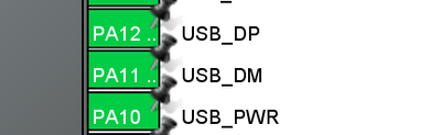

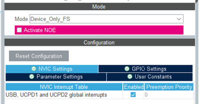

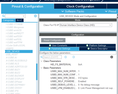

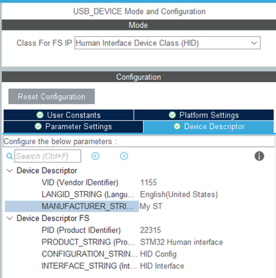

Hi
These are setting i have implemented... In main USB init is done.(only Cube mx generated code) rest everything is empty. When i run the code it suppose to show device name under my devices in my windows.
Am i Missing any thing... Thanks for helping out..

I am able to connect via custom board when i changes setting to custom HID. But After my PC detects its showing driver error.
2025-05-07 11:59 PM
In CubeMx when i configure device as HID Device it properly listed in My PCs device driver.
But when I change to Custom HID My PCs device driver is detecting device but showing driver error.
Just an update i saw. any way this can be resolved?
