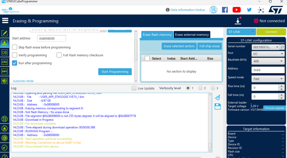

Hi ST Team,
I'm using ST's openbootloader using i2c protocol. But facing following issues while implementing using stm32cubeprogrammer and ST-Link V3set:
1. After reset the user application is not running
2. Not able to flash new firmware after 1st time flashing(Checked the binaries: Previosly flashed firmaware binary is at that location)
Please help to solve the mentioned issue.

Hello @Pranil and welcome to the Community :),
I recommend you to take a look at Introduction to open bootloader, these video can help to use and to implement an open bootloader.
I hope this help you!
Thank you.
