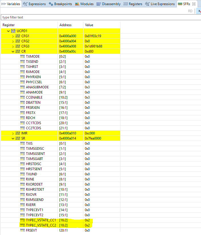

FRTSTXx lines will not affect CC lines. Could you please dump the UCPD1 registers to check the status of CC lines? Did you manage to probe CC lines and to check the CC lines level?
