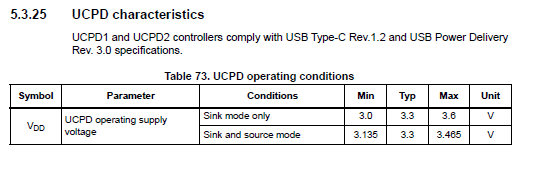

About the question 2, you must take care about the operating condition (see chapter 5.3.23 of the STM32G071CB datasheet)
BR
Dominique
2019-07-23 2:49 AM
Hi Dominque
Yes I do take notice and asked our hardware guy to bridge the mcu to 3.3V, because we already noticed another problem that not even GoodCRC is sent from any device, so we checked hardware and the upper bound voltage of CC line is only 0.74V, much lower than requried 1.04-1.2V per PD specification.
Anyway, I can confirm that raising the voltage of VDD to 3.3V solved my question 2, but we still don't get any GoodCRC just for your interest :(

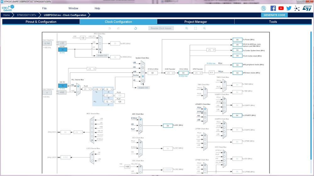

Hi Dominque,
Attached is the settings from STM32CubeMX, from what I can see it should be the same as G0 demo except PLLN/PLLR, but final clocks are the same
I am now out of office but my final test today is connecting the prototype to my Nexus 6P phone and the phone do says "Quick Charging", but because the only PDO now is 5V 500mA I don't know why "Quick Charging" is displayed:downcast_face_with_sweat: I hope that's just because it did recognized a PD source and if that's the case I can assume my case solved and move on to the other parts of the system.

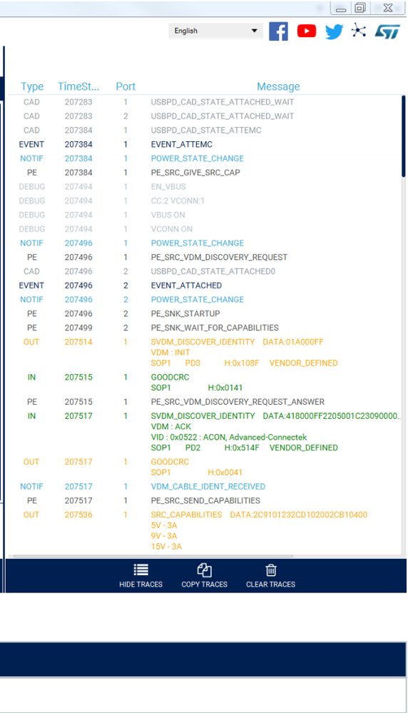

2019-07-24 1:03 AM
Hi John
Please could you send me the USB-PD trace ? i could help you to analyse if there is an issue.
FYI, our software solution embedded is own trace system which could be a great help to analyse USB-PD issue. So i recommend you to enable it, this could be done through Cube-MX (enable the utilities TRACER_EMB and tick the box "Tracer Source (TRACER_EMB)"
And you shall use the UCPD Monitor tools to catch the trace
