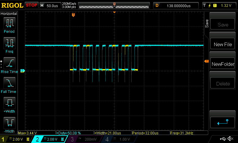

Here is the transmission :
It looks fine to me, the master seems to properly send the 0xA2 write command, but the slave doesn't pull the SDA line low on last clock. Unless of course I am not understanding I2C correctly.
