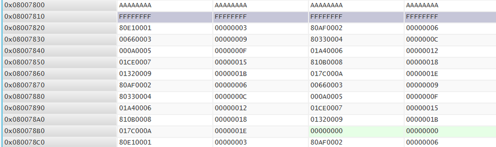

I unlock the flash, the Init the EE emulation, write 10 variables (check if a cleanup is required), then read back the values.
This works ok. After running this code a couple of time I get:
I'm not sure why I have 4*32 bits with 0xFFFFFFFF on 0x08007810.
Then I get 16 bits VA (0001) 16 bits CRC (80E01) and 32 bits value 00000003.

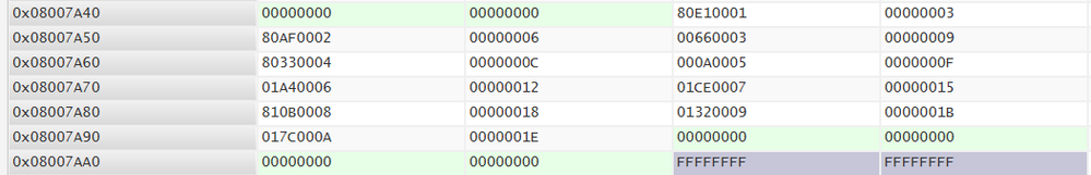

Then I want to try to read data after power off. So I comment back writing operations, flash the code and connect with STM32 Programmer to read the data. I get the following:
each time I re-connect the programmer (and so a reset is made) 2x32 bits 0's are written into the flash. It's come from ee_status = EE_Init(EE_FORCED_ERASE); calling that is forcing the write of those 0's. I've tried with EE_CONDITIONAL_ERASE but the same happens.
