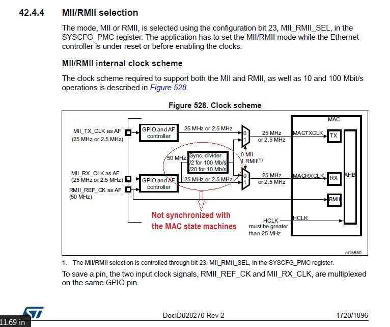

Hi everybody,
The following is my analysis and a proposed workaround about the RMII bug in STM32F7 rev A.
Analysis.
The problem is due to the lack of synchronization between the 50MHz ref clock sync divider and the MAC internal state machines.
At start up the sync divider starts randomly in the ''right'' or in the ''wrong'' way.
If it starts in the ''wrong'' way the packets received are not passed correctely from the PHY  to the MAC and this is  detected by the crc calculation: as a result the packets are dropped and the crc error count in the MMCRFCECR register is increased.
If it starts in the ''right'' way everything works fine.0690X000006045KQAQ.jpg
Proposed workaround.
The following is an automatization of the tip proposed by Richard Peters in this thread.
Thank you Richard :)
1) Init the Ethernet peripheral.
2) Set the PHY in local loopback, I.E. set bit 14 in PHY_BCR register.
3) Read the MMCRFCECR register and store it contents.
4) Transmit a packet with the first six bytes set to 0xFF, I.E. a broadcast.
5) Wait a while, E.G. 100uS.
6) Read the MMCRFCECR register and compare it with the previously saved value.
7) If it is equal jump to point ''12'' else procede to the next point.
8) Switch the RMII_REF_CLK pin to normal input, I.E. disconnect it from the sync divider.
9) Switch the RMII_REF_CLK pin back to the ethernet alternate function, I.E. riconnect it to the sync divider.
         Point 8 and 9 gives to the sync divider the chance to restart in the ''right'' way.
         After few tries it will synchronize in the ''right'' way and everythings will work fine.
10) Go to point ''3''
11) Disable PHY local loopback, I.E. clear bit 14 in PHY_BCR register, to allow normal functionality.
12) The bug has been patched, we can go on.
Any comment is welcome.
Regards
Marco
