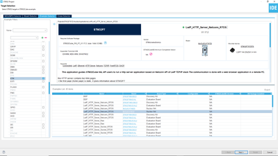

Hello @simenvoffa ,
You can access the application for STM32F767ZI board that guides you to run a http server application
based on Netconn API of LwIP TCP/IP stack : ( Github Link) LwIP_HTTP_Server_Netconn_RTOS
Make sure to follow the instructions in the README file to set up your project correctly.
