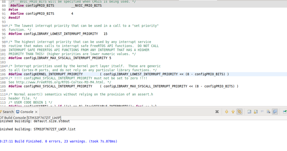

FreeRTOS has a kernel IRQ priority level. No interrupt service routine which references an RTOS API can have a higher priority. Check the FreeRTOS configuration header to see what the kernel priority level is.

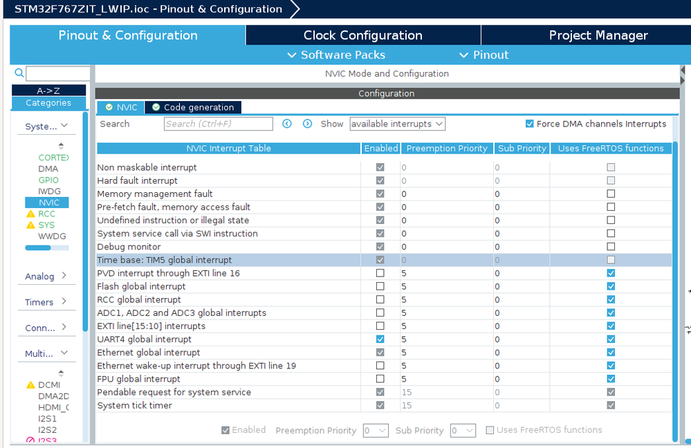

These are my Interrupt Configuration settings. All the Interrupt handlers seem to have the same Priority as the the configLIBRARY_MAX_SYSCALL_INTERRUPT PRIORITY. Which seem to be ok. Or am I missing something?
2022-10-07 6:58 AM
You were talking about TIM6 but the screenshot shows TIM 5 (at wrong prio NVIC 0) ?

It's OK for HAL timebase interrupt to be above configMAX_SYSCALL_INTERRUPT_PRIORITY. One just cannot use any FreeRTOS API in such interrupts.
