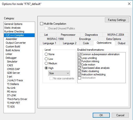

Is it a disadvantage of having longer pipeline? Because F429 performance is better over F767 for a simple execution.
I am running both hardwares in high optimization
My concern is F767 is taking more time for malloc ,creating OS tasks and printf's and other major tasks than F429.
Or some configuration i can change to increase the speed. Or i can conclude F767 is slower than F429
