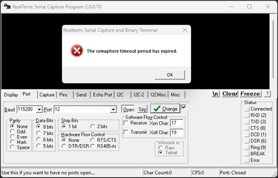

All standard windows applications fail to connect to the USBX com port. These applications connect fine to the same com port if created with the old STM32 USB device driver library. Attached are images of the com port as enumerated on windows, and the error received on Realterm. Realterm appears to be timing out in trying to connect to the com port, and this seems to be the issue in all my other applications as well.
Thanks
Justin
FBL
Hi @justin23
Ok. Would you print debug messages from USB library? I it's indeed enumerated but it seems like it is not configured correctly. I noticed you are not issuing error handlers. Do you have the same when configured in HS mode?
