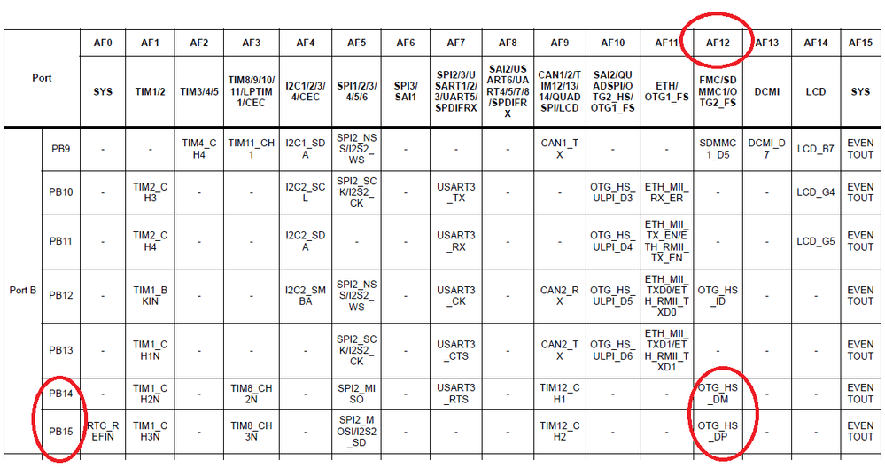

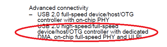

2017-07-04 3:11 AM
Hi
thakur.sushant
,The STM32F746 and the STM32F439 devices embeds a:
I assume that, for your application, you want to use the second controller in FS mode. Thus, you should use PB14 and PB15 pins.
You may refer to
,table12, to have a complete idea about the alternate functions mapping on the STM32F746 devices.GPIO_InitStruct.Alternate = GPIO_AF12_OTG_HS_FS;
Khouloud.
