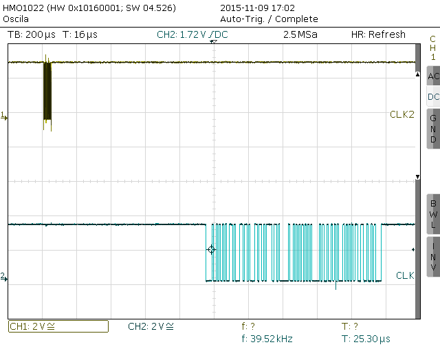

I'm trying to use multiple UARTs on the STM32F446 Nucleo board. I used STM32CubeMX to generate code that initializes all available UARTs and USARTs at 115200 baud and the MCU to run at 180MHz.void

However I only receive output on UART2 and UART3, all other UARTs are silent.
When connecting a scope it turns out that the other UARTs are much faster (the yellow line is UART6, the blue line UART3).
2015-11-09 10:24 AM
It works when I use
RCC_OscInitStruct.PLL.PLLN = 160; instead of
RCC_OscInitStruct.PLL.PLLN = 180;
Does that mean the MCU will only run at 160MHz?
2015-11-09 1:21 PM
I'm pretty sure APB2 would need to be slower than DIV1, and flash wait states greater than 3, for 180 MHz operation. Review the RM
