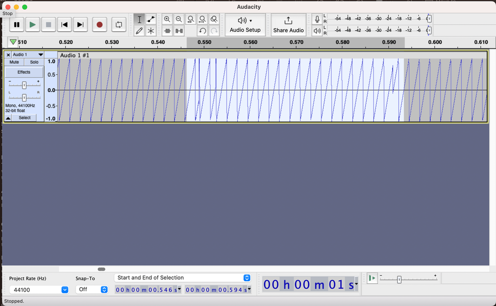

I'm stuck. I'm able to send a 440 Hz sawtooth wave to output over USB from Nucleo board (device) to my computer (host).
The only problem is, there's this repetitive clicking / choppy sound in the resulting audio when I record with Audacity. The click happens relatively regularly, like 1.3x per second.
Another issue, I'm not sure if it's related or not: When I sweep the frequency from 440Hz to 880 Hz using a potentiometer, I can audibly hear the sweep happening twice. It's like USB is caching or reusing some buffer or something. (Tried to link code and audio examples but it's restricted because I'm a new member)
Maybe there's some clock issue? I think I read somewhere that the Nucleo's built-in crystal oscillator (8MHz) may not be suitable for USB due to some out-of-sync issues with USB communication.

2023-03-08 9:50 PM
After reading more about USB audio streaming (in particular, 1.) UM2195 User manual USB device audio streaming Expansion Package for STM32Cube and 2.) Universal Serial Bus
Specification)
it sounds like clock drift isn't something that can be cured simply by using the most accurate clock, because there will always be a minuscule amount of drift.
It sounds like there are three ways to alleviate clock drift: asynchronous, synchronous, and adaptive.
I've tried setting bmAttributes as synchronous, but that didn't help.
Maybe I need to use the same epType (same bmAttributes) in my call to USBD_LL_OpenEP.
Or maybe there is something else I need to be doing.

2023-03-10 4:10 PM
So I sort of figured out what was going wrong.
Although my SOF callback was getting called every 1ms, USB was really only ready for data transmission every 3ms (the reason for this I'm still not sure, what would like to find out at some point).
So rather than Transmitting 1ms of audio data per transmission, I needed to Transmit 3ms of audio data.
So I just multiplied the size of my buffer by 3, and now it works.
