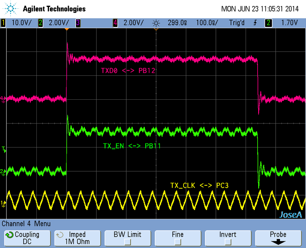

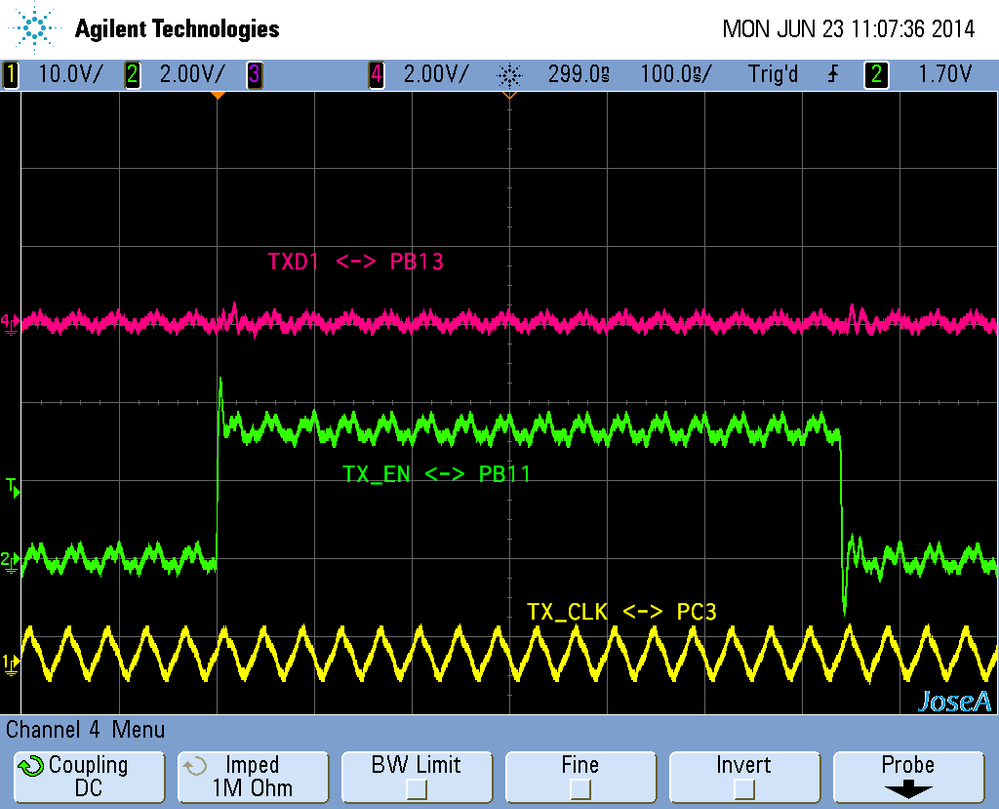

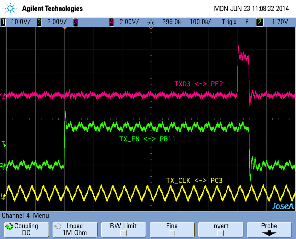

I am experimenting some trouble with the transmission data pins from STM32F4 (TXD0-3). With an oscilloscope, I have tested this pins and the signal is always the same (and wrong). Reception pins work fine.
Also I have tested the same source code with an STM32F4 evaluation board, and all work OK.
I wonder if anyone has had similar problems with Ethernet MII connection.
Thank you.

Issues with Ethernet PHYs usually come down to a couple of things:
Pin configurations and connection.
Clock speeds, routing, expectations.
PHY configuration address, and internal configuration.
I don't see any code or schematics, and don't really know what ''wrong'' means in this context.
Suggest you look at other STM32 designs that have used this Micrel part successfully.

At this moment I can't access to the physical device to get the waveforms from the MII interface. I will check these points and  I'm trying to upload more information on Monday.
Regards, Jose A.

Posted on September 15, 2015 at 07:21
My STM32F4 shows the exactly same unwanted waveforms on TXD[3:0] in MII Mode. The width of TXEN signal shows also only 600~700 nsec as you have observed. Please share your valuable solution.
