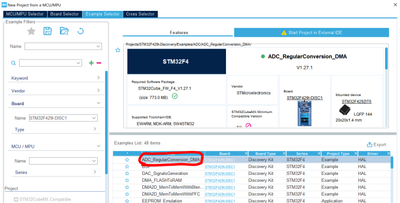

Go into the example selector and load the ADC_RegularConversion_DMA. That gets you the DMA part. It should be trivial to change that from 1 channel to multiple channels. There are other examples with more channels for other boards, you can use those as inspiration.
