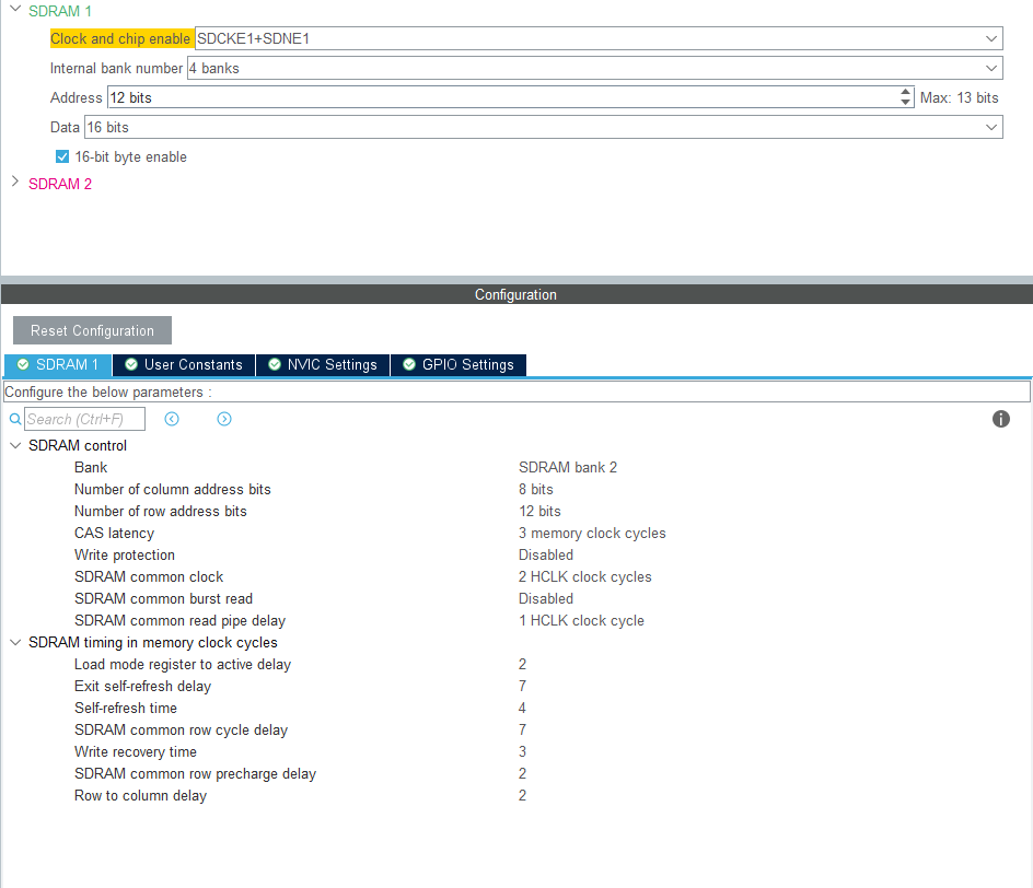

hello i have stm32f429i-disco card. fmc settings are configured. i defined sdram in the linker file but variable sdram is not written. can you help me? i am using cubeide. my linker file is attached and i am attaching the photo of my fmc settings. my variable definition is as follows __attribute__((section(".sdram"))) uint8_t frame_buffer[320 * 240 * 2];

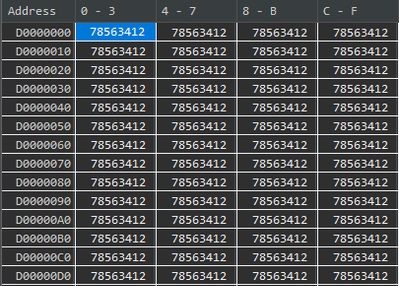

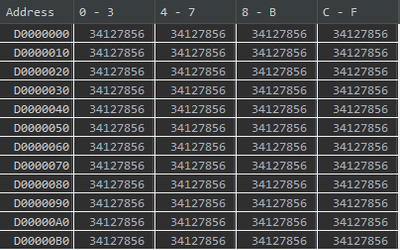

I found what I was missing from the file you linked and added it and I can write data to sdram. But the data I write is in a mixed order. I am putting the code I wrote below as a picture and the value I read from memory in debug.
uint16_t *sdram_address = (uint16_t *)0xD0000000;
for (uint32_t i = 0; i < 1024; i += 2)
sdram_address[i] = 0x1234;
sdram_address[i + 1] = 0x5678;
2025-05-08 11:50 AM
uint32_t *sdram_address = (uint32_t *)SDRAM_BANK_ADDR;
for (uint32_t i = 0; i < 1024; i++)
sdram_address[i] = 0x12345678;
2025-05-09 1:11 AM
Did you try to read it back in the code? I think this is something expected while reading the SDRAM content from the watch.
2025-05-10 7:46 AM
Hello, it was as you said. When I read the data back, it was in the written order.Thank you.
