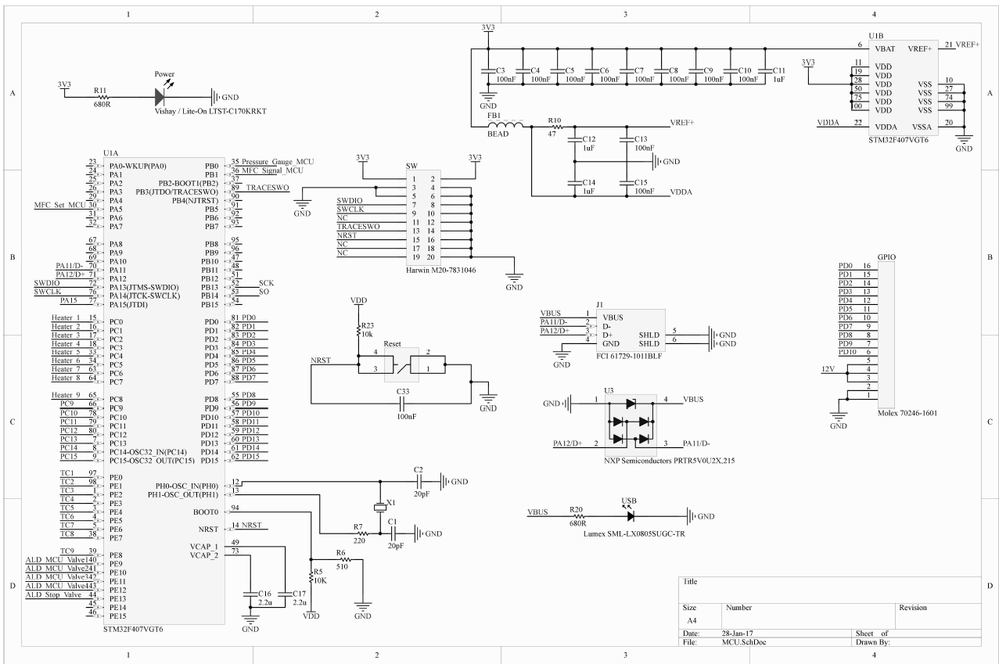

The only hardware difference, I could find between my PCB and Discovery board regarding USB connections is that there is a 22 ohms serial resistor in D+ & D- lines. In fact, I scratched lines one of my spare board and soldered 22 ohms resistors to mimic Discovery board. Unfortunately, It didn't change a thing.

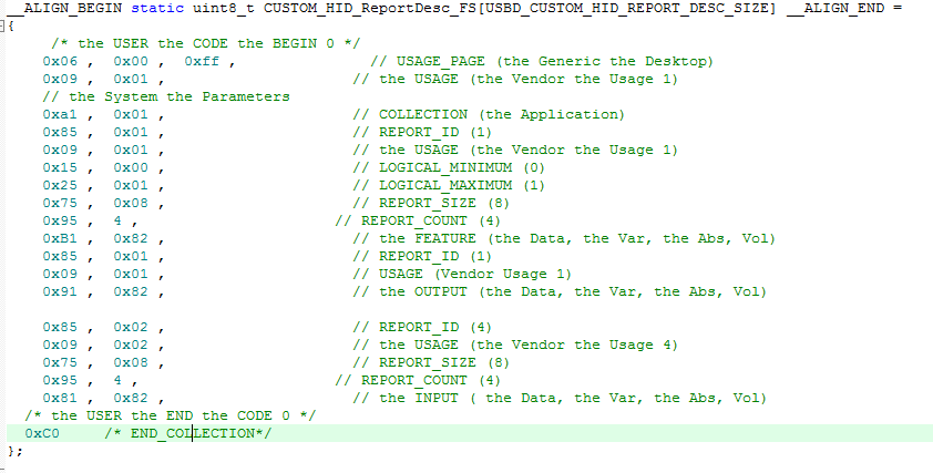

So, I don't know whether my problem is from hardware or software. Here is the CUSTOM_HID_ReportDesc configuration,
This setup is working in DISCO board, but has no effect on my PCB.

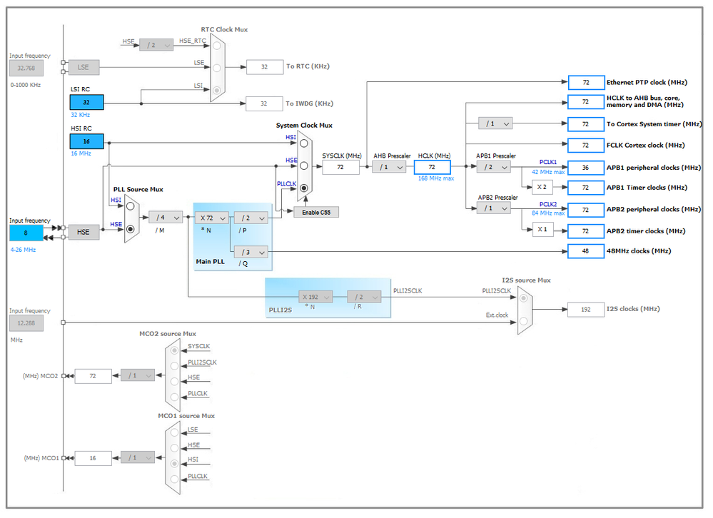

I even used the same clock configurations and tried both selecting DISCO board and STM32F429 chip in CubeMX. Examples I find online guide me to here and right now I am in a dead end. Any help will be

ed, thank you for your time and knowledge before end.Note: I attached PCB schematic and USB project.
